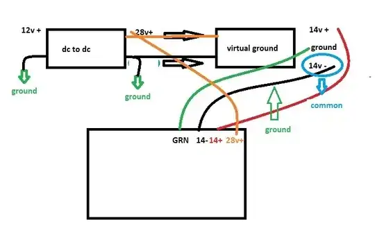

check C4 capacitor in ur power supply as in my picture.
    Where did this schematic come from and does it relate to the question? – David Feb 25 '20 at 22:49
  • Do you say that using a capacitive coupling across primary and secondary, as in your picture, help to solve my problem ? In which way? In any case the power supply is external to my board. – Fabio Feb 26 '20 at 22:15
