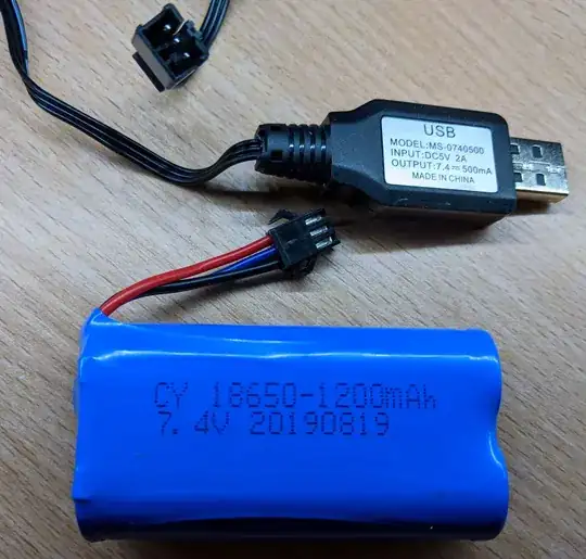

I recently bought a remote control toy for my son which included 2 2S battery packs, with a single SM-3P plug, and a corresponding USB charger as shown here.
Initially, the car worked fine, though within one or two uses (can't recall now), one of the packs simply stopped powering the car, even though the supplied charger seemed to charge the pack successfully.
Soon after, the other pack has done likewise.
I have confirmed the car works fine when I wire up another 2S LiPo pack to it using jumper leads, so it is clearly the supplied packs that are under question.

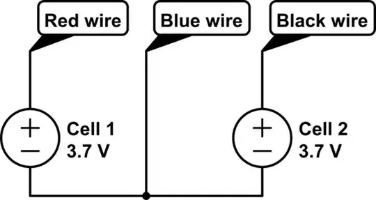

I applied a volt meter across the terminals of the batteries. What I found for both packs is making me question my sanity:
  • positive and negative terminals of the volt meter across corresponding battery terminals - 0v
  • positive (volt meter) to positive (battery), negative (volt meter) to center (blue) battery terminal - roughly 4.1v
  • positive (volt meter) to negative (battery), negative (volt meter) to center (blue) battery terminal - roughly 4.1v
suggesting the following internal wiring...
This just raises so many questions in my head:
  1. How can a circuit like this provide 7.4V output?

Lastly, for the avoidance of doubt, the SM-3P battery connector in the car has only two pins, which connect to the red and black wires on the battery, as you would reasonably expect.

UPDATE: Have cut away the insulation now. Here's what I found:
Also, I tried reading the voltage off the charger pins without the battery connected, but can't get a consistent result. It appears to oscillate quickly between about +3V and -3V, though difficult to be certain of those figures. My multimeter (Uni-T UT139C) doesn't update quite quickly enough.
UPDATE: Confirmed cells read normally when tested individually, per comment from Bruce. One reading 4.2v at present, the other reading 3.9v. (Oddly, I'm still getting 4.2v and 4.1v when reading across the plug pins... must be some function of the PCM causing this.) Voltage in series is 8.1v
Likely then that the PCM has malfunctioned somehow (in both batteries)? Perhaps the charger has caused some damage?
UPDATE 15-Apr-2020: So I finally received the replacement PCMs I ordered from AliExpress today. I am now ready check myself into an mental asylum. After switching the old module out for the one of the new modules, the behaviour is exactly the same. I even tried connecting the old and one of the other new modules to a separate pair of 18650 cells I had and got the same behaviour consistently. 0v across the power terminals of the PCM and voltage seemingly reversed when testing across the P- and BM (guessing this stands for Battery Middle?!) terminals of the module. Testing across the B- and BM terminals gives a reading as you would expect from testing the cell in isolation (that is, it isn't inverted!), though the reading is consistently around 0.1V or so off from the negative voltage reading gotten from P- and BM (similar to what I observed previously). Where do I go from here? How did this ever work? What am I doing wrong?

    It appear that the cells are in series and that you should get 4.1V across each individually (full charged) or 3.6V nominal and 8.2/7.2V across the pair. it APPEARS that one cell has reverse pilarity. - This "DOESN'T HAPPEN" with LiIon cells - but may with NimH/NiCd sort of sometimes. Cell in left photo with visible terminal by red lead should have +ve at that end and other cell should have -ve at this end. Is that what you measure ?(not according to your text). | Summat bad. – Russell McMahon Feb 19 '20 at 01:30
  • Now that the battery wrapping is off we see that it has a PCM (Protection Circuit Module). If any cell is abnormal this will probably have turned off and disconnected the negative side. Please measure the voltage across each individual cell (positive end has white ring) and the voltage of both in series (ie. the ends shown in the photo). – Bruce Abbott Feb 19 '20 at 06:29
  • Thanks guys. Have added an update there. Should have thought to check the individual cells myself last night after taking the wrapping off! – John Rix Feb 19 '20 at 11:39
  • Given the problem appears to be with the PCM, I can get a replacement for that for about €1 on AliExpress (https://www.aliexpress.com/item/32984739873.html), but I'm wondering if this would suffer the same fate as the first two - that is, is it more likely the charger caused the problem and needs replacing? – John Rix Feb 20 '20 at 23:07
  • An 18650 battery cell rated for only 1200mAh indicates a VERY poor quality battery cell. A Name Brand 18650 is usually 3500mAh. – Audioguru May 22 '22 at 16:56
  • Attention, the given schematic of the pack is wrong: cell 2 is shown in wrong polarity! The pack can not have 7.4 V with this wiring - and the images shows that + of cell 2 connects to - of cell one. – datenheim Jan 30 '23 at 19:05
  • I couldn't agree more, it does not make sense, and yet that is what I observed using my multimeter across the individual wires. I never solved this problem, even after replacing the PCMs. Just had to give it up as 'one of those things', a waste of money, and move on with my life. – John Rix Feb 06 '23 at 18:50
My 2 cents coz had the same problem with my grandson's rc. The stock battery died after 4-5 charges. Simply, get new 2 pieces 18650 battery. Unwrap the stock battery pack, unsolder the wirings with the balance connector. . Use that same wire exactly on the new batteries. Bingo, you just save couple of dollars for stock replacement battery! Test using the balance connector, will read cell 1, cell 2 and total charge.
  • In my case, the individual cells were still fine. I never solved this one and simply could not make sense of what the PCMs were doing. I eventually bought a replacement battery of the correct type for the car from AliExpress. Even with that, the car ran a couple of times and then the individual motor drivers on the main board burnt out, one by one until the car would not move at all. Can't find a replacement board for the car. Pure waste of money and so annoyed about the whole affair. :-( – John Rix Mar 31 '21 at 11:23
