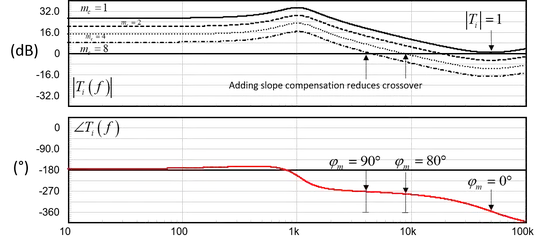

enter image description here what i understand :
clarify coniditons :
fet calculation :
1)Vgs min :
from zero thermal coeffcient , from gaph : Ids , Vgs , to prevent thermal runaway
2)Vgs max : from datasheet Vgss
3)Vds max : From Safe operating Area graph , before thermal instability line, and keep in mind power limit .
