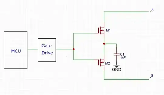

One of the functionalities include having continuity between 2 pins on the PCB (Volt free contacts), which are connected to an external controller (Master). Since the supply can only supply 1mA, I am using 2 n-channel Mosfets for their high input resistance. However, I don't know how to switch them since they're connected to an external circuitry with different voltage references (grouds), and the mosfet switching works around the gate to source voltage (Vgs(Threshold)).
One idea I had was to connect the Mosfet sources together and put a 1nF cap to ground so the voltage from the MCU would be with reference to both sources of the mosfets. enter image description here

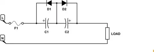

I also saw the attached picture in an application note from Texas Instruments (Application Report SLVA948–December2017), But I don't have any prior experience with charg pumps and am a little bit worried regarding their current draw and I also don't know the voltages that master controller might exert to check continuity so i don't know how higher the voltage should be when fed into the gates.

  • What voltage is your gate drive circuit running at? And more importantly, what voltages are you encountering at A and B? Do they have a common ground or are they floating? How much current do you expect to flow when they're connected? – Cristobol Polychronopolis Feb 14 '20 at 13:26
  • Hi @CristobolPolychronopolis , the gate drive is driven with a 3.3V regualted voltage. As for A and B, they sometimes get connected across a common pin and a digital output, and as they are volt free contacts I think it would have about 12V dc across it. However, in some other cases, they are just connected acroos 2 GPIOs. But I am certain the current would not exceed 7.5 mA. – NeuroEng Feb 14 '20 at 14:27
