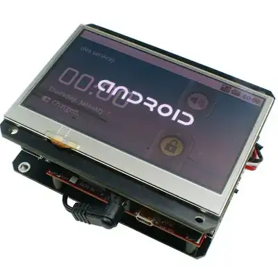

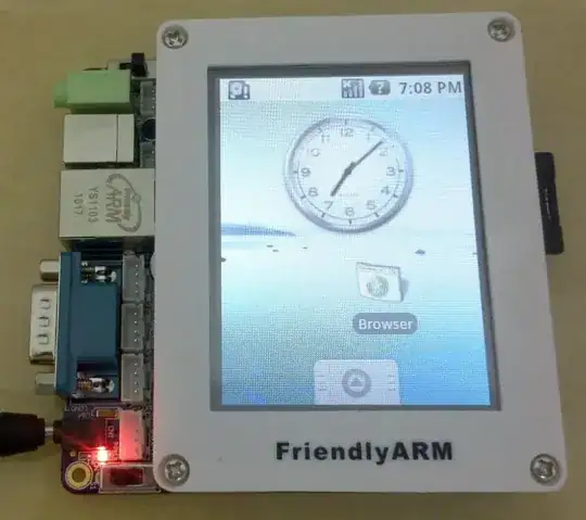

There are various, but I'll suggest the FriendlyArm Mini2440 with 3.5" Display and Touch Panel. See images bellow of the Sergio Prado's blog:
alt text
