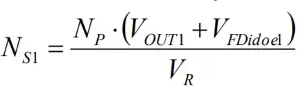

From Np = 24 turns, I calculate the secondary winding using below equation (assume Vout = 24V, Vdiode = 1V, Vr = 90V)
Image 2
From that, I will get Nsec = ~ 7 turns
Therefore Npri = 24 turns, Nsec = 7 turns.

  • If the transformer is designed for a Flyback, keeping the same ratio, will keep the reflected voltage similar so don't need to change the rated voltage of the secondary diode. – Delphesk Feb 11 '20 at 08:54
