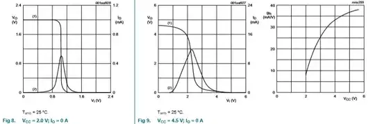

Few inverter spec sheets include \$r_o , g_{fs}\$ that may help tell if oscillations will start. For CMOS inverters, \$r_o\$ is inversely dependent on Vdd, while \$g_{fs}\$ is directly depenedent on Vdd.
74HCU04 swept characteristics from NXP 74HCU04 data sheet
Crystal manufacturers help guide us by specifying load capacitance for their crystals. When a parallel resonant crystal is loaded with this capacitance, and driven with the few volts available from an inverter, crystal current flows roughly in the right ballpark. An added series resistor could be used to adjust drive strength and/or start-up time.
