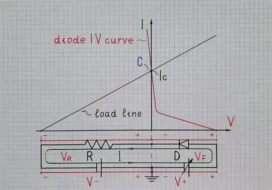

The problem here is that OP thinks the voltage drop across the diode is VF (about 0.7 V); so, including a voltage source with the same voltage VF, the result should be zero. However, this is valid if sufficient current flows through the diode (e.g., it is a basic requirement for a Zener voltage stabilizer)... and this requires higher supply voltage, which in this case is nowhere to be taken. As a result, as professionals say, "the diode is not properly biased". I have graphically illustrated this situation in Fig.1. Let's examine it.
Fig. 1 - Unbiased diode
Fig. 1. To work properly in the vertical part of its IV curve, the diode should be properly biased
To work properly (in the almost vertical part of its IV curve), the diode requires more significant current (IB) that can be obtained by higher voltage V and the resistance R. As a result, the load line (in brown) intersects the diode IV curve in the middle of the vertical part - the so-called "operating point" B, and the voltage drop across diode is VF = 0.7 V.
However, the OP's input voltage is only VF. So the load line has significantly moved to the left... and now it intersects the diode IV curve in the (almost) horizontal part of the IV curve - point A (the operating point has moved from the B to A position). Now the current IA is insufficient... and the voltage drop across diode is less than VF.
So, formulated in this way, the question has no practical value. It is just an undesired situation in the analog diode applications. But if somehow the diode is properly biased, the OPs question makes sense and can illustrate many interesting and important applications.
"Biasing" simply means "adding" constant voltage to the existing input voltage (V+ in the figure). If there was not a ground, there would be only one way to do it. But as we usually ground the diode (as in the figure), we can do it in two possible ways - from the side of anode ("pulling" it up) and from the side of cathode ("pulling" it down). Let's consider the latter as more interesting and more easily implemented - Fig. 2.
Fig. 2 - Biased diode
Fig. 2. Biasing a diode from the side of cathode
To bias the diode, we have connected another (but negative) voltage source V-. As we can see from the voltage picture (red bars), we can adjust V+ to make it equal to VF of operating point C (in the middle of the vertical part). As a result, the "output" voltage (of the cathode) is zero (the so-called "virtual ground"). As though the voltage V+ has neutralized the voltage drop VF across the diode... and the total voltage of this network consisting of V+ and D is zero. Figuratively speaking, we can think of the network as of "ideal diode" with zero voltage drop VF. Moreover, with more imagination, we can consider the voltage source V+ as a kind of "negative diode" -D that removes the "positive diode" D. It is negative since it adds voltage while the ordinary diode is positive since it subtracts voltage.
The name of this technique (can be) "voltage compensation"... where we compensate an undesired voltage drop by equivalent voltage in a series manner. It can be passive if VF is compensated by another VF across an equal diode. This technique is widely used to bias output (op)amp complementary stages with diode and "active diode" networks connected between transistor bases. Another application can be found in H&H AE (page 52, Fig. 1.93) where a diode log converter is compensated this way.

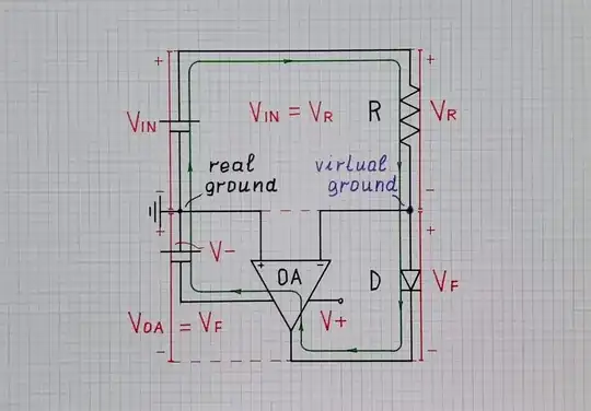

However, quite more interesting is the active voltage compensation. We can see it in the circuit of an op-amp log converter if we draw it in a more unusual way - Fig. 3. The elements with positive voltages are drawn above the zero voltage line (ground); the elements with negative voltages are drawn below the zero voltage line.
Fig. 3 - Diode log converter
Fig. 3. In the op-amp log converter, the op-amp compensates VF by adding equal voltage -VF
The op-amp acts as the variable voltage source V+ from Fig. 2 above. It "goes" below zero to add voltage VF in series to the diode. As a result, the "output" voltage of the anode is zero (virtual ground)... the op-amp has neutralized the voltage drop VF across the diode... Figuratively speaking, we can think of the combination of (properly supplied) op-amp, power supply V- and imperfect diode as of an "ideal diode" with zero voltage drop VF... or, as above, we can think of the op-amp as a kind of "negative diode"-D that removes the "positive diode" D...
