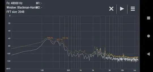

Addendum #1.1. Just have captured audio spectrum when there is no station chosen. Surprisingly I see quite tall peak at 240-260 Hz region: it's ~30 dB higher than 50 Hz peak and goes away fully if I shut down bass timbre regulator fully. This is quite strange. Wikipedia article gives another example of 50 Hz hum which contains 300 Hz peak in spectrum.
Addendum #1.2. Re-captured some audio spectra during nighttime (Blackman-Harris/2048). Here are spectra for two cases: bass timbre potentiometer turned off and on, respectively:
bass timbre off bass timbre on
As could be seen baseline level ups by ~20 dB when bass timbre regulator is at full-on position. Also here are three main peaks arise: 140 Hz, 257 Hz and 351 Hz. Doesn't seem to be ground loop issue but here are three more waterfalls (Blackman-Harris/512): turning bass timbre off, on and cycling it on-off-on:
turning off turning on cycling
Here are small increase of 50 Hz frequency band could be observed but three previous peaks rise much steeper.
Question #1. Are there any ways/advises how to suppress such hum and what can cause it?. Should I get another power cord and connect Protective Earth wire to the receiver chassis? Are there any pitfalls of connecting DC power rail (in that case metal chassis) to the mains Protective Earth (I mean could any dangerous situations with mains, e. g., short-circuit somewhere on the line potentially damage my receiver)?

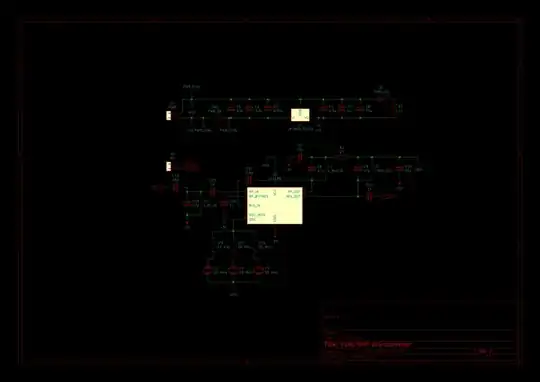

Addendum 2.1. Here is new schematics for CCIR/OIRT converter built on LM7905 for clarity:
ccir/oirt converter schematics
Question #2. Just want to be sure, there are no differences what power rail - VCC or GND - becomes copper filled (and connected to the enclosure/chassis), am I right? If not, what are pros/cons of making VCC-filled PCB and connecting VCC plane to the external aluminum case (with screws, for example)? Would it act as Faraday's cage for converter's PCB placed internally?

    First off, are you sure it's 50Hz (and not 100Hz)? It can be hard to tell the difference to the untrained ear. Second, a better way of thinking about how your circuit is set up is GND and VEE (negative voltage supply) instead of GND and VCC (positive voltage supply). At least that's how the voltage regulator is set up. – W5VO Feb 06 '20 at 02:41
  • I've just measured audio spectrum and found that there is no 50 Hz tone. Instead I can see quite tall 240-260 peak (~30 dB higher than 50 Hz peak) which goes away if I shut down bass timbre fully. Very strange, on the [Wikipedia](https://en.wikipedia.org/wiki/Ground_loop_(electricity)) there is example of 50 Hz hum which gives peak at 398-400 Hz. I'll retest at evening - the signal usually much louder than now. Regarding filling plains: can I safely replace all +9V labels with GND and GND with VEE? I'm just creating LM7805-regulated converter PCB in KiCAD and want to do all properly – Drobot Viktor Feb 06 '20 at 08:46
    Interesting. If the tone knobs get rid of the hum entirely, then the power supply (and audio stage) isn't likely the source of the power line noise. While ground loops can cause hum like this, you don't really have a ground loop (unless you have grounded test equipment hooked up at the same time). Replacing the labels is probably fine, but your new circuitry will likely expect GND to be the most negative voltage, which can cause issues if you're not careful. – W5VO Feb 06 '20 at 10:12
    Just to be clear : where PNP transistors predominate, +V IS ground... (VEE) because all the collectors are connected to -ve (VCC). If you're regulating for this circuit, consider a 7905 instead of 7805. –  Feb 06 '20 at 11:45
  • *W5VO*: I can add global label VEE to the schematics and connect all ground pins of my circuitry to it so minimizing chances of messing things up. *Brian*: there is no principal troubles to still use LM7805 and connect receiver's GND (actual +9V) to the LM's input pin and receiver's VEE (actual 0V) to LM's GND pin, right? Then I can just pour (receiver's GND)/(LM's input) zone on the bottom of my PCB and connect it to the aluminum case making chassis and converter's case equipotential. I assume in that case things become just inverted and there will be no problems with weak ground etc... – Drobot Viktor Feb 06 '20 at 15:07
  • Asking more specifically: could I consider this large +9V rail (receiver's chassis GND) copper filling on my PCB acting as usual large areas of canonical GND in modern schemes? I worry how to properly shield converter's PCB and it's external aluminum case to prevent picking up external RF interference in that weird case – Drobot Viktor Feb 06 '20 at 15:13
    @DrobotViktor Use the '@' to make sure a user sees the message. I would discourage you from getting comfortable calling your supplies 0V and +9V, as that implies a certain familiarity that is definitely not appropriate. You are working on a (by modern standards) unconventional power supply system - be very careful to think about assumptions that you are making when transferring positive rail circuits to a negative rail system. Using a 7805 would give you a positive output voltage of -4V, and a negative output voltage of -9V. – W5VO Feb 06 '20 at 21:59
  • @W5VO why? If I connect receiver's chassis (which is at +9V) to the LM7805 Input pin and minus wire from the receiver's power supply (number 28 in the original post, 0V) to the LM7805 GND pin then I should have +5V regulated output on LM7805 Output pin. Actually this is how I connected my test converter built on breadboard and all worked fine. I think the only question here is it good to fill spare PCB place with copper connected to the receiver's chassis and also connect converter's case to it too. Will it serve as Faraday's cage in that case for the converter? – Drobot Viktor Feb 06 '20 at 22:54
    A 7805 (positive) voltage regulator outputs a voltage that is 5V greater than its GND pin. Any noise or disturbance on the GND pin also gets shifted to the output pin. If the GND pin is -9V +/- noise, then the output will be -4V +/- that noise as well. When you use that circuit, you will have no power supply immunity between stages. It would be better to use a 7905 (negative) regulator to generate -5V, and power your circuit from 0V and -5V. Your copper fills could then be 0V, making it easy to integrate into your radio. – W5VO Feb 07 '20 at 00:08
    I don't know the condition or topology of the other components in your radio, which would influence how significant this issue is for you. The range of scenarios that I can think of go from circuit failure, to demonstrating poor performance, to having some glitches every so often, to being perfectly fine. If new "weird" behaviors emerge, that's probably the first thing I'd think about when troubleshooting. Maybe not "Thar be dragons!", but "Thar be weather service warnings about iguanas falling from trees!". – W5VO Feb 07 '20 at 00:17
  • @W5VO so if I'll use LM7905 then I could connect all GND pins of my ICs, LEDs etc to the -5V output pin of LM chip and all VCC pins of ICs, LEDs and so on to the GND pin of LM, right? Then pouring with LM's GND net (which is actually tied to the chassis) will get me proper shielding on PCB and converter's case as well, right? – Drobot Viktor Feb 07 '20 at 14:19
    Yes, that's probably the best reasonable case. Making an inverting +5V supply from the -9V rail is the "proper" rail topology, but it's probably not worth the hassle. Just remember, any noise that ends up on the -5V rail will be almost perfectly coupled into your converter circuit output - don't skimp on power supply decoupling. – W5VO Feb 07 '20 at 16:40
  • @W5VO thank you a lot, I think I got it. What about other points? Will these shieldings (PCB copper zone, aluminum case, coax braid) work as intended (I mean as usual GND filling/grounding/shielding)? May be my doubts are just because I've never worked with negative-powered systems and that case confuses me. – Drobot Viktor Feb 07 '20 at 20:23
  • Yes, it will mostly do everything you're expecting. Making copper pours, cases, and coax GND/0V instead of -5V/VSS or even -9V/VEE makes the most sense because it's probably safest and most convenient to do that inside the radio. It will probably (there are a few possible exceptions) behave the way you are expecting. Try to keep a similar power supply notation (and PCB silkscreen!!) to the original radio schematic so you don't mix yourself up between your new board and the old radio. Good luck! – W5VO Feb 07 '20 at 21:00
  • @W5VO thank you a lot, you're great man! If there was post by you instead of comment I would accept it as answer. I've added schematics if someone curious about it. – Drobot Viktor Feb 07 '20 at 21:21
First off, it can be hard to tell the difference to the untrained ear between power line frequencies and their harmonics. It's really important to try and measure the frequency (or frequencies) of the noise, as that can provide important clues as to what might be wrong. Measuring the spectrum with a microphone-based FFT worked really well. If the tone knobs get rid of the hum entirely, then the power supply (and audio stage) isn't likely the source/entry point of the power line noise. While ground loops can cause hum like this, you don't really have a ground loop (unless you have grounded test equipment hooked up at the same time).
The fact that you're seeing only odd harmonics of the power line (fundamental at 50 Hz, 3rd at 150 Hz, and 5th at 250 Hz) is interesting. Not sure I have enough to go on past that to be uesful. Even harmonics, or ones starting at 100 Hz might indicate poor power supply electrolytic capacitors, but we don't see that here (and you said you replaced them). I probably wouldn't try to change the manufacturer's earth grounding strategy, as that's probably not your issue.
