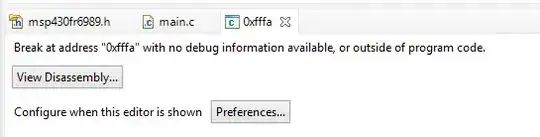

I build it and there were no issues and started debugging it with my IDE (CCS v9.2).
Stepping into the instructions inside the main function and enter the select_clock_signals () function was not an issue, when I leave the function I got this error.
I tried:
  • Writing a simple light the LED program in a new project, and I didn't get the error
  • rearrange the code so the assign_pins_to_uart() will be called before the select_clock_signals(), and I get the error when the debugger leaves the clock signal function.
EDIT2
I tried debugging my code, and at CSCTL2 = 0x0046; the value of the register automatically changes to CSCTL2 = 0x004E;. so when DCORSEL = 1, FSEL automatically becomes 7.
I don't understand why that happens, as in the UG and the Datasheet they don't mention anything about the value of CSCTL2 being changed by the MSP430.

CSCTL1 |= (DCORSEL | DCOFSEL_3);//DCO 8Mhz 0x0046
The comment is wrong. This sets the FSEL field to 7, which is invalid and results in 24 MHz, which does not work without more FRAM wait states.
If you do not want to keep any bits that happen to be set in the register, do not use the | operator.
And you should clear the password after you have initialized the clock registers; here is how TI's msp430fr69xx_cs_01.c example program does it:
  // Clock System Setup
  CSCTL0_H = CSKEY >> 8;                    // Unlock CS registers
  CSCTL1 = DCOFSEL_6;                       // Set DCO to 8MHz
  CSCTL2 = SELA__VLOCLK | SELS__DCOCLK | SELM__DCOCLK;  // Set SMCLK = MCLK = DCO
                                            // ACLK = VLOCLK
  CSCTL3 = DIVA__1 | DIVS__1 | DIVM__1;     // Set all dividers to 1
  CSCTL0_H = 0;                             // Lock CS registers

  • Sorry for the late reply, I don't understand why does setting the `DCORSEL` bit will cause the `FSEL` bits to 7, as in the data sheet and the user guide, it specifies that if `DCORSEL = 1` and `DCOFSEL = 3` then `fdco = 8MHz`, but when I debug the code I find that `DCOFSEL` becomes `7` even though I specfiy it as `3`. I will put it on *edit2* – Embedded_Dude Feb 06 '20 at 11:33
