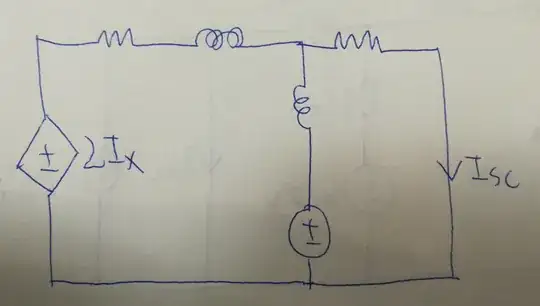

When I tried to solve this problem, I tried to find the Thévenin equivalent circuit by finding the open circuit voltage, using this diagram: enter image description here and then I tried to find the short circuit current using this diagram: enter image description here and then calculating Zth using the formula Zth = Voc / Isc
However, this gave an incorrect answer. Apparently, the correct way to find the Thévenin equivalent is by cutting off both the load, and the current source to the right, like so: enter image description here and to find the short circuit current, enter image description here and then using the formula Zth = Voc / Isc to find the correct Zl which draws maximum power.
I don't understand why finding the Thévenin equivalent with the current source attached gives an incorrect answer. Any help is very much appreciated!

  • According [this site](https://alan.ece.gatech.edu/ECE3040/Lectures/CircuitReview.pdf) you choose the correct approach. Could you write out the equations, maybe there is an error in? – Huisman Jan 31 '20 at 12:08
  • The answer to the banner question is ... because an ideal current source has infinite impedance, hence looks like an open circuit. But if you're calculating the Thevenin impedance from Voc and Isc, as the question in the text implies, the impedance of the current source does not arise. – Chu Jan 31 '20 at 15:49
