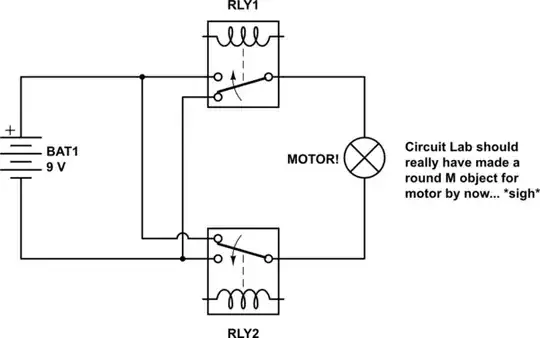

I made a Constant Temperature Anemometer using this and this as reference. However, I'm having trouble in making it work properly. To get the circuit started I need the emitter voltage (Bridge Top) to be negative but can't seem to get it. No papers nor discussions i searched seem to have this problem. My questions are (details below):
  1. I'm trying to find out what happened when a closed loop circuit like this has just turned on. Specifically, where should i start placing initial voltages to do analysis?
  2. How do I achieve negative voltage at the bridge top to make the circuit work properly?
  3. Should I change the 10k pot in the offset circuit?

  • Yes there are some simple errors but 1st define all the R values at equilibrium and output voltages. Then expected output range, gain and offset and satisfy CM input range. Generally show V+ above V- in diagrams – Tony Stewart EE75 Jan 21 '20 at 00:53
  • Did you try reversing the polarity between your bridge and the in-amp? – brhans Jan 21 '20 at 01:08
  • Hi Tony, the bridge that I showed in the pic is in equilibrium and that would make the OPA37 output roughly be the same as the Offset circuit output. I expect the output range to be around negative 5~10V (depending on the operating condition required). I obtained the gain and offset value from references since it deals with frequency response of the system. Also I'm not sure what satisfying CM Input range means. As for the diagrams, i think flipping the opamp would make the circuit look like a mess – LRZ Students Jan 21 '20 at 01:16
  • @brhans Yes, when the bridge top is negative, the In-amp output will be positive. Part of the OPA37 job is to reverse the In-amp output so that the transistor base is negative. Problem is, the bridge top is positive which leads to positive at the transistor base – LRZ Students Jan 21 '20 at 01:23
  • I'm not referring to the top of the bridge. I'm referring to the inputs to U2 on pins 2 & 3 and suggesting you swap them over. – brhans Jan 21 '20 at 01:25
  • @brhans Ah, no i havent. I'll try it and post the result – LRZ Students Jan 21 '20 at 01:29
  • @brhans Changing the inputs wouldnt solve the problem since the inamp output needs reverse the polarity of the Vbridgetop – LRZ Students Feb 13 '20 at 02:20
The bridge should be about 10% of the emitter voltage pulled up by your operating offset.
This ought to be within the Vcm input range for desired output. But you can check that.
As far as phase margin and reactive compensation , we'll leave that for another question.
  • Wait, so this would mean the U1 feedback resistor should be connected to the emitter? I'll also try this – LRZ Students Jan 21 '20 at 01:39
  • Yes and you need NPN to pullup because the PNP has no pullup shown and would be inefficient as PNP emitters only pull down which the HWA already does on its own – Tony Stewart EE75 Jan 21 '20 at 02:02
  • The 100 Ohm resistor is optional. – Tony Stewart EE75 Jan 21 '20 at 02:08
  • Is it stable? ... – Tony Stewart EE75 Jan 21 '20 at 05:07
  • I'm still in the middle of testing. The bridge is only stable very close to the operating point. Probing the system with oscilloscope or even multimeter made it unstable. Also rotating the offset pot P1 have no effect at all to the output. I think I need to test this with a Hotwire instead of placeholder resistor. It would take some time, I'll update after testing. Sidenote: I'm still new to this site, so I'm not quite sure if I need to close this question and open another after testing. – LRZ Students Jan 21 '20 at 08:26
  • Update schematic with pin#'s , and get Bridge top to stable value. Add RF caps where you need stable DC voltages , keep wires short as possible, use twisted pairs,list make a list U1-x __V . You may need an LDO to supply offset, not just diodes & Pot. Edit this question to improve it. You will probably need to reduce AC gain with series RC feedback in the > xx Hz range. Show photo of layout – Tony Stewart EE75 Jan 21 '20 at 12:40
