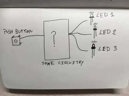

I'm trying to learn some electronics and I have something in mind that I don't know if it is possible to achieve.
I've worked before with micro-controllers (Arduino, etc) and I know I would be able to do this with code, but I would like to know if this is possible without any code/micro-controller.
I would like to have a push button and 3 LEDs.
  • First time you press the button, first LED will light.
  • Second time you press the button, second LED will light (and the first one will be off).
  • Third time you press the button, third LED will light and the second one will be off.
If you push it again, every LED will be off. And then the process will start again with every press of the button.
I hope I was able to explain it correctly
Is this possible??
Thanks a lot.
