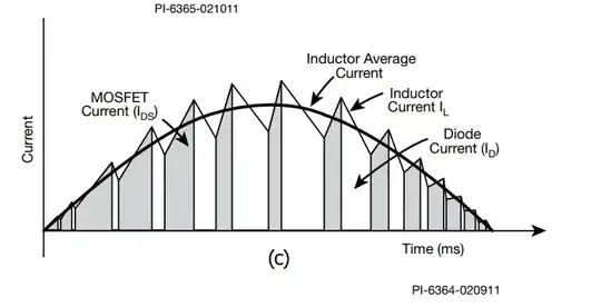

I know that the result duty cycle should look like to this:

The outer control loop starts by comparing the measuring the output voltage, \$v_{meas}\$, to the reference voltage level, \$v_{ref}\$. The resulting error, \$e_{volt}\$, is fed to a voltage controller (PI\$_{v}\$). The controller output can be thought of as the needed average or RMS current needed to feed the output load. In the next step, this value is multiplied with a dimensionless signal that gives a instantaneous current that is the same shape as the grid voltage with zero phase shift, \$i_{ref}\$. Again, the reference current is compared to the measured value, \$i_{meas}\$, to produce an error signal, \$e_{current}\$, which is fed to the current controller (PI\$_i\$). The current controller output can be thought of as the instantaneous duty cycle, \$d\$, for the boost converter switch, Q. The duty cycle is transformed to a PWM signal by comparing it to a sawtooth signal. The duty cycle over a half period will start high, then decrease, and then go high again towards the end. This is the same as in your figure "c)", where the duty cycle follows the grey area.
