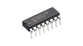

My suggestion for this task would be to use an analog to digital converter chip (ADC) for the inputs and send this to the microcontroller, which interprets the information and codes it according to your communication protocol and then sends it to the HC-05. An 8-channel ADC can be seen below. Such an ADC connected to the ATtiny85 communicates with SPI or I2C, which are bus protocols needing few wires.

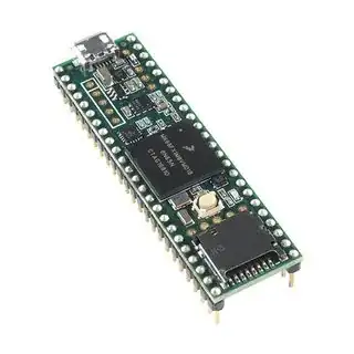

Alternatively, you can use something like a Teensy 3.6 as it already has enough analog inputs. Of course it's bigger and way more powerful than what you need for your purpose. This will be up to you and how much convenience you want in your project. Teensy 3.6 pictured below:
Teensy 3.6

  • Thank you. I will try the first method but I'm looking at the MCP3008-I/P ADC and it has only 8 analog inputs, and I need 12. – JingleBells Jan 10 '20 at 10:59
  • Great. You can use two of the 8-bit ADCs of course, or find another 4-channel ADC. – C. K. Jan 11 '20 at 16:45
