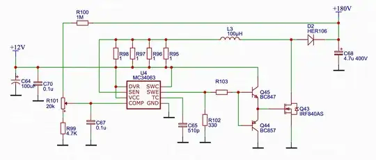

I am trying to make nixie clock and I use MC34063 for buck/boost converters. The nixie tubes require 180 V to operate and the microcontroller and LEDs need 5 V. I use external 20 V power supply as a source. Here are the circuits:
5V enter image description here
180V enter image description here
When the circuit is powered I can hear an annoying audible noise. The sound comes from all small SMD capacitors. It sounds something like 13 kHz sine wave. I power the raspberry pi from the 5V line and it's capacitors become noisy too.
I have tried to change 100 uH coils to 220 uH, but it didn't change anything. Please help.

UPD2: I measured the frequency of the timing capacitor charge/discharge:
The 180 step-up converter is running at 47 kHz enter image description here
The 5v step-down is running at 49 kHz enter image description here
I also noticed a weird behavior of 5V's timing capacitor when the LEDs are on enter image description here

  • Are you sure that C65 is the correct value? 510pF should yield an operating frequency of 50kHz, 5.1nF would be more like 10kHz. – Spehro Pefhany Jan 08 '20 at 02:05
  • Maybe I should really change the timing capacitor. But are you sure that the capacitance should be increased? More capacitance = more time to charge = lower frequency. Am I wrong? – George Jan 08 '20 at 11:40
    I’m suggesting the capacitance should be as marked on your schematic, but might, in fact, be larger. – Spehro Pefhany Jan 08 '20 at 15:10

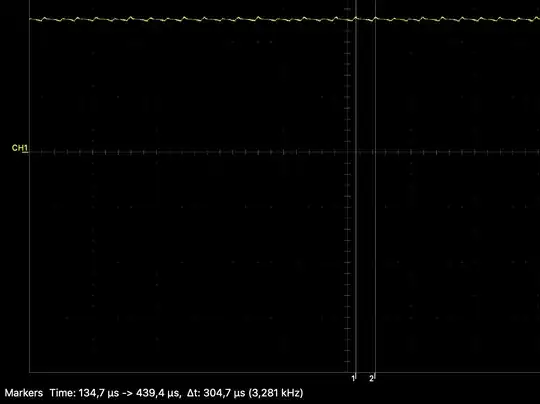

What you are hearing is most likely the piezo-electric effect from the MLCC capacitors - as various other comments and answers stated.
Your oscilloscope shot shows a 3.81 kHz oscillation with 300 mV on the 5 V line. This is very much audible. As your switching frequencies are all outside the audible range, the source of the oscillation is very likely from an unstable (or marginally stable) control loop.
I suggest, that you debug the buck and the boost separately. Turn of/disconnect one and work with the other. You alter the control loop by playing with C59 (in case of the5V buck) and C67 (for the 180 V boost). Increase those slightly and observe the 3.81 kHz with 300 mV amplitude on the 5 V. Does it change? Getting smaller? Then we are on the right track. Disadvantage: increasing those caps makes your control loop slower, and react slower to input voltage fluctuations and load changes. Might not be an issue for you though.
