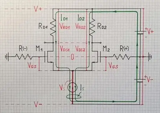

  • @ Kinka-Byo, When the lower end of the current source is connected to a negative power supply, the MOSFET sources can go down below zero so the gates are at zero input voltage. This means there is no need of some biasing from the side of gates since the transistors are biased from the side of sources. Only the gates should be somehow connected to ground - either through the input single-ended sources or through additional resistors (see the picture below). – Circuit fantasist Jan 06 '20 at 19:41
