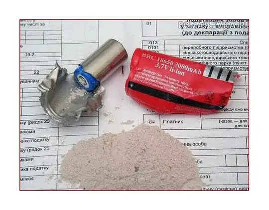

    I think that depends on the honesty of the seller... Quite often power-packs with 5V USB output are marketed with the mAh rating of the internal 3.6V batteries. Of course the mAh rating of 5V output would be lower. – bobflux Dec 30 '19 at 21:32
    IF a LiIon AA had a 833 mAh 3.6V mean LiIon AA core and a 1.5V constant output then - LiIon energy = 833 x 3.6 =~ 3000 mWh capacity. The max likely output would be about 90% of that (a good buck converter) so say 2700 mWh. So mAh of output at 1.5V constant = 2700/1.5 = 1800 mAh at 1.5V delivered. I'd not be surprised if the LiIon Wh and 1.5V mAh were advertised :-) :-( – Russell McMahon Jan 01 '20 at 08:30
    Nice picture ! :-) – Russell McMahon Jan 01 '20 at 11:28
    There's a dude on youtube who bought a 4x18650 cells USB power bank, disassembled it, one 18650 was legit and all the others filled with sand XD – bobflux Jan 01 '20 at 12:45
