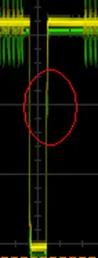

These don't seem to be a problem; the 3.5V Pk-Pk seem inside range, given the oscillations of the power supply. But zooming out on the HSync:
Green is after the 74xx245, yellow is before. There's so much noise going on when the signal is high, that it actually pushed the envelope to 4.06V! How's VSync side-to-side with HSync?
Not bad; but not a pretty signal, though, considering I'm filtering both of them with a couple of 22pF capacitors.

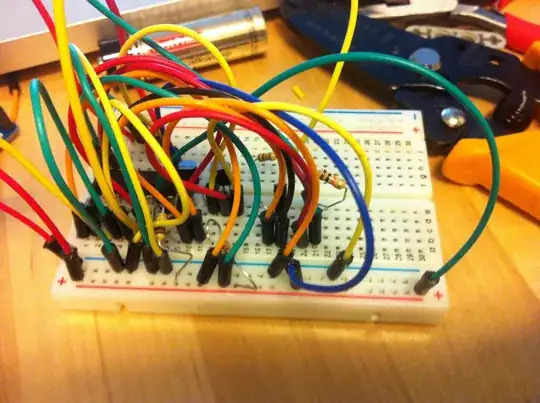

After reading a lot here about wires, and also here thanks to @Peter Smith, I decided to cut the cables that connect to back of the monitor to about 1/3rd of their size (they had around 1m, and are 24AWG). The ghosting is way better now, but you can still see some weird superposition:
Here's the physical setup photo, as some requested (sorry for the xmas-themed table towel):

Based of the extensive discussions above, I think the problem is with the OP's interface between his breadboard and the VGA display itself. Secondary to this may be the breadboard setup itself.
OP agrees that the only thing that has made a noticeable difference is when he shortened the wires from the breadboard to the display from 1M to ~ 12 inches. That has to mean something.
Single ended, unshielded wires from the 'HC245 to the display is not the proper way to send 100 MHz+ signals. In the short term, as I think someone else suggested, I would twist a ground wire with each signal going to the display, and connect that wire to GND on both ends.
Ideally, in a perfect world you should have 5 coax cables to the VGA display.
SteveSh
  • 9,672
  • This was exactly what did the most difference. I made twisted pairs for each signal with GND, and the ghosting was reduced significantly. It's still not perfect, but it is far better than the initial image. – Hugo Sereno Ferreira Jan 08 '20 at 01:12
