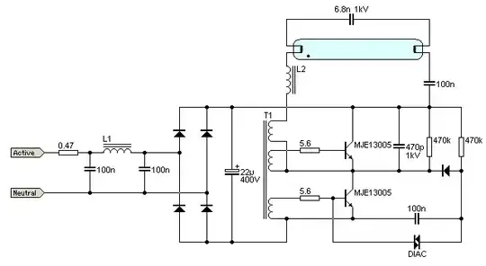

Here is a somewhat typical ballast. As you can see, if one of the many components has failed short, current will flow from active to neutral. The diodes in the rectifier part of the circuit or one of the transistors can fail in this way.

    There will be a small current flow through the two X2 caps in the front-end filter, basically no matter what, anyway... – ThreePhaseEel Dec 25 '19 at 02:37
If they are oldskool inductive ballasts, then removing the tube will open the circuit.
If they are electronic ballasts, they're like power supplies, so even without tubes installed they will be powered.
However if there was smoke or "fried electronics" smell it is possible that some wires have melted insulation so I'd really recommend opening up the fixtures to check. Cut the power from the panel, you never know if the light switch really does cut the live... or if Protection Earth is actually connected... Better safe than sorry.
