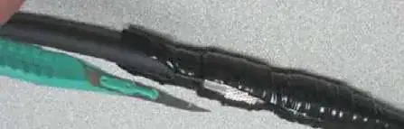

I prefer 3M Temflex™ 2155 Rubber Splicing Tape, but there is also Scotch® Super 33+ which has a PVC backing for UV protection as an additional layer.
Carefully pry away with a pointed 1-edged razor knife to easily remove it.
