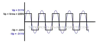

Such inverters usually produce "pseudo sine wave" or "modified square wave" output. Not quite a square wave but a swuare wave with off period so the overall form factor and RMS values are closer to a sine wave.
Image below from here
