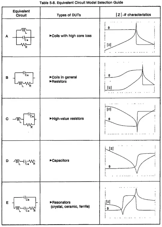

Quick Answer: According to Page 5-37 from Operation Manual of the 4195A Network/Spectrum analyzer equivalent circuit selection guide.
  • The First is for Resistors in general
  • The Second is best suited for High-Value Resistors
Long Answer:
I found a tutorial on equivalent circuits and simulation models from a Passives Handbook called : ABC of CLR from the European Passive Components Institute where they discuss the equivalent circuits which the HP4195A impedance analyzer uses to analyze and calculate the Device Under Test.
Page 5-37 from Operation Manual of the 4195A Network/Spectrum analyzer shows diferent equivalent circuits and type of DUT they are expecting for its analisis.
I'm attaching the table as it perhaps may aid in deciding which equivalent circuit suits which component when modeling them.
Table 5-8. Equivalent Circuit Model Selection Guide
This image is (C) HP / Agilent / Keysight , but since the product is obsolete and the manuals are freely available from the keysight website, I don't believe there should be a problem in reproducing it here
Pau Coma Ramirez

    Upvoted. I only just got a chance to read this and it's an excellent answer. FYI it looks like Keysight removed that manual from their website, but you can also download it [here](http://www.tentech.ca/downloads/hardware/HP4195A/04195-90000_4195A%20Network-Spectrum%20Analyzer%20Operation%20Manual.pdf). If that breaks too, I had luck by putting the manual part number (04195_90000) in a search engine. I'm always impressed by how much really useful information you can get from these old HP equipment manuals. – MattHusz Apr 12 '22 at 15:56
