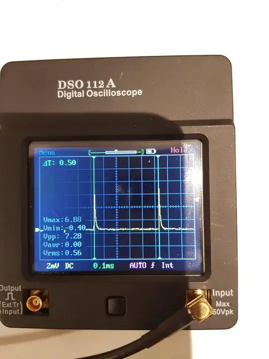

And this is the reading I'm getting:
This measurement is consistent. When removing power it goes flat so it originates from my circuit.
Questions
  • Is the setup I'm using good enough for measuring sub-milliampere currents?
  • Why Vmin is less than 0? The scope is calibrated and when removing power it goes to 0.
  • Is it correct to use Vrms as the "average DC measured voltage"? It so, it means that the average current draw is 0.00056 / 0.5 = 1.12mA
  • Regarding those 7.28Vpp spikes every 500μsec:
    • I would like to find their source.
      The circuit is a printed PCB with SMT parts so I prefer not to rework it, if possible. What would be a good way to debug it and find the part that creates these spikes?
    • Since these spikes are very short and at a (more or less) steady frequency, my guess is that they come from one of the ICs on the board, and not from analog discrete parts. But looking at their datasheets, I couldn't find any reason why any of them would consume ~14mA every 500μsec when the system is in a deep sleep mode.
      Any idea?

  • Why would anyone have any idea; no data sheets, no circuit, no idea. Also, try connecting your current sense resistor so that the scope is grounding the negative rail of the supply. – Andy aka Dec 16 '19 at 10:04
  • @Andyaka fair enough. I gave a list of components above but I didn't really expect everyone to start reading their datasheet to analyze this. The question is more about: 1. Am I measuring and understanding this correctly? 2. How should I further debug this (which good practice), regardless of what the exact components are. – Amir Gonnen Dec 16 '19 at 10:08
  • Regarding the current spikes, here is what I would do: 1) Check each of the device's datasheet to try to identify which has the more chance to wake-up every half-second 2) If no conclusive evidence from datasheet readings: disconnect or force reset line low on each IC and check if spike is still there 3) After identifying the IC, check datasheet for current consumptions, identify which mode it is likely in, compare averaged current too 4) If not the mode you expect, start diving into the IC registers to figure out if some peripherals/clock are still on and correct those modes. – eeintech Dec 16 '19 at 17:51

  • Your suggestion was very useful! I've added a large capacitor and tried a sense resistor of 10/100/1000 Ohm. Now I measure a consistent 160-200μA which makes more sense (albeit a bit high). Do you have any idea why the original value I got with the 0.5 Ohm resistor (1.12mA) was so high? Could it be related to the scope's sensitivity? or to some artifact of the circuit/measurement setup? – Amir Gonnen Dec 17 '19 at 07:31
  • 200uA * 0.5ohm is 100uV. Does your scope have that sensitivyty, or offset? I have another answer to this question which you might be interested in, but it's more complicated and untested. [current sensing nA to mA](https://electronics.stackexchange.com/questions/255646/current-sensing-na-to-ma/255654#255654) – Neil_UK Dec 17 '19 at 08:25
