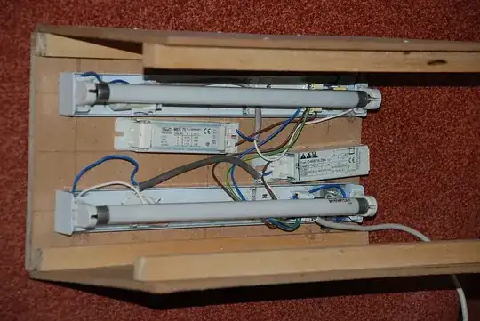

I get excellent results with a cheap HP DeskJet 5940 printer and Mega Electronics JetStar Premium film, using positive pre-coated boards in a home-made UV exposure unit made from MDF and a few strips of wood. I use a sheet of glass in the exposure unit - it's transparent to long-wave UV. I keep meaning to add another tube to decrease the exposure time, it takes 11 minutes.
It's best to have the UV tubes some distance from the artwork/PCB, as it increases the resolution due to the collimation effect. I have done 5 mil tracks as an experiment, but usually use 10 mil.
exposure unit
