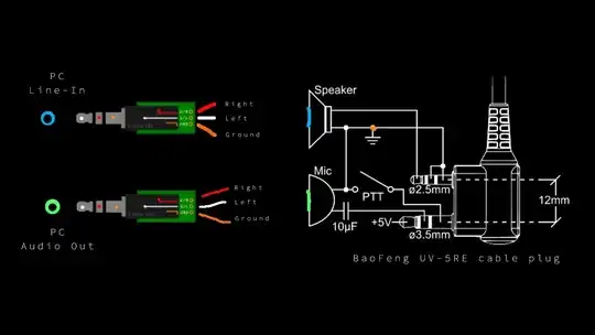

I've got a cheopo BaoFeng UV-5RE that I'd like to try as packet radio.
I've snipped the plug off of the headset that came with the handheld, soldered it onto some breadboard cables, and did the same to one 3.5mm jack plug connector intended to go in the soundcard. (I'd prioritize getting listening to work through line-in, first.)
But, having done that, at least one after thought hit me: the speaker-out on the BaoFeng is mono, while the port(s) on the soundcard is intended for stereo.
Would anyone be able to help me out with a wiring plan?
Feel free to doodle further on the image for rough illustration.
(Sorry for the hasty sketch. And I realize the line-in and out of the PC is perhaps in reverse location. I'm not entirely sure.)
BaoFeng to soundcard line-in/out wiring
Push-To-Talk is not very important per se, since the radio apparently have 'VOX' function, but if that's not recommended maybe I could use an Arduino that I got for the task some sort of (Linux) serial-PTT and perhaps also as some sort of a go-between the radio and the PC entirely?
