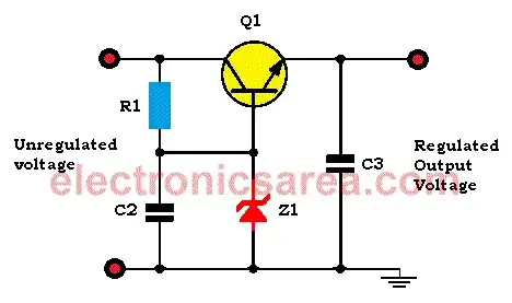

A linear regulator like the LM7805 or a zener + transistor based circuit like this one:
form a series regulator (not shunt). These regulators have the advantage that they consume only as much current as is needed. When the load takes no current then there is only a small amount of power used.
These circuits are slightly more expensive as a transistor is needed or a voltage regulator chip like the LM7805.
