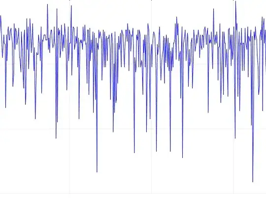

It's a Zener diode, and the applied voltage is sufficient to cause the avalanche effect. The signal at the output looks like:-
plot
which is a log normal distribution spanning about 3Vp-p.
My approach is to calculate the RMS voltage of the output, add a load resistor and then measure the difference in RMS values. From that I can determine how much voltage is 'dropped' across the circuit's internal impedance by the current flowing through the load resistor. And thus obtain \$Z_{out}\$.
I don't have the RMS code yet so I can't try it, but is this the correct approach?
NB. Looking at the signal plot, 90% of the peaks are independent of each other. There's only a slight correlation as the signal is almost pure white noise. Is an RMS calculation even possible?
Sure, but getting a good average value will need a lot more samples than if the noise was gaussian, so make sure to let it run for a long enough period of time and take several measurements to check if the RMS value is repeatable. The noise signal has a lot of spikes, so you need to acquire enough of it to not have one or two extra spikes change the average value too much vs the accuracy you want.
