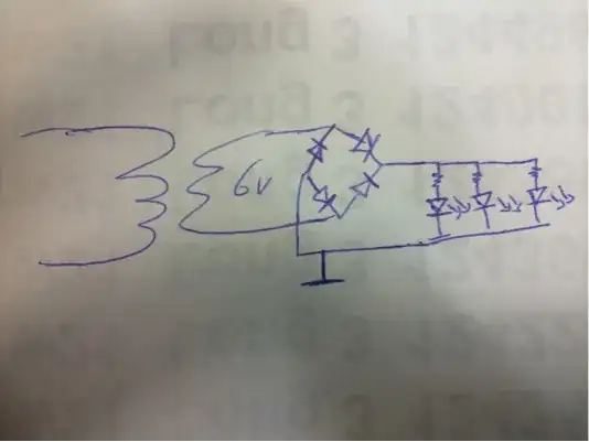

EDIT 1 : THE POWER SUPPLY
There is no information about "isolation" on laboratory power supply documentation. I just found a basic schematic here :
Power supply basic schematic
I open the case and I found a transformer, power cord go directly to the primary of the transformer (through fuse and main switch) so power supply seem to be isolated.
