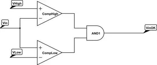

Inspired from this schematic, the idea is to put diode in series with the load, to use forward voltage as limiter for the optocoupler SFH6206-3 like the following schematic:
