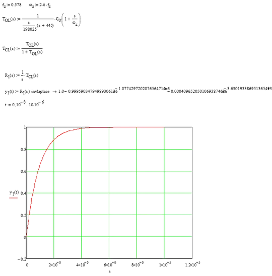

One we have these data on hand, we can test the closed-loop response to a 1-V step;
The response is perfect and the error is null as expected.

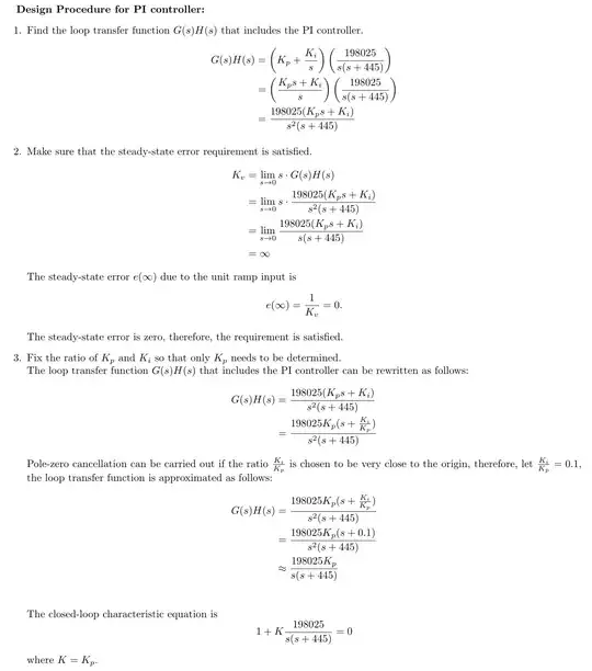

I don't have time now to type it.
Now it is easy to design \$K_p\$ to meet the transient response. Just construct the root locus and proceed from this point.
