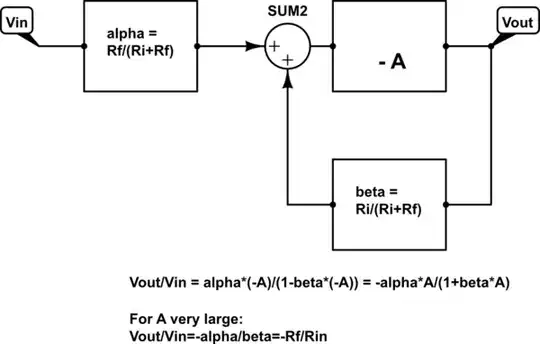

In case of an inverting opamp configuration there is no negative sign at the summing junction of the block diagram (two signals - input and feedback - will be superimposed at the inverting input node) - therefore, a negative sign must be used for the open-loop gain A.
Of course, we still have negative feedback (because there is a minus sign in the feedback loop).
The block "alpha" is required because the input signal is not applied directly to the opamp input node. Both factors (alpha and beta) result from the superposition theorem applied to the inverting terminal (Voltage V-)
V- = Vin*(Rf/(Ri+Rf) + Vout*(Ri/(Ri+Rf) = Vin*(alpha) + Vout*(beta)
We have also
V- = - Vout/A (V+=0, non-inv. input grounded)
Equating both right sides gives us:
Vout/Vin= - alpha*[A/(1+beta*A)]
A visual interpretation of this transfer function leads to the following block diagram for the inverting opamp configuration:
