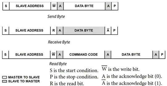

enter image description here Picture from here... not my picture.
The master should be programmed to read the same length of the address frame as the slave, which is defined by the datasheet of the slave. You also may be able to set an address of a slave but usually not by much. This will help addressing conflict if two slaves share the same address.
Here's an example of a part that I actually just recently worked with, it's an ADM1276 hot-swap controller. It abides by the PMBUS specifications but the I2C topology still applies. It tells you the interactions of master and slave when you're sending, receiving, reading, and writing bytes.
