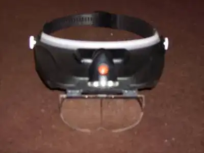

The most essential tool for me is a headband magnifier: alt text
finnw
  • 153
  • Thanks for the pic, what brand is it, what is your feedback regarding this device? – Kevin Boyd Jan 17 '11 at 16:50
  • @Kevin Boyd, it is from [modelcraftcollection.com](http://www.modelcraftcollection.com/). The magnifier is very convenient, allowing you to see the components from any angle (unlike a helping hand magnifier whose position is fixed.) The lamp is less important as you generally have a desk lamp pointed ad the object anyway. – finnw Jan 21 '11 at 17:33
