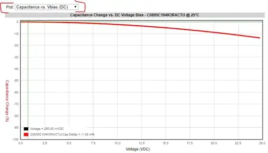

You won't find it in most datasheets. You have to go to the manufacturer's web site. For Kemet, here is an example Choose your cap through their search tool, then choose the KSIM button. Then select the DC bias plot. dc bias plot

  • In your quick answer, better to use 0805 package, if I used 12V power supply how much capacity would drop, and does that apply to classic THT capacitors as well? – Smekeri BezPrezimena Nov 14 '19 at 18:24
    It's best to use the manufacturer's datasheet or website to look at a specific part and how it behaves. No it doesn't generally apply to through hole components, as the issue has to do with very high dielectric materials and very thin layers. – Aaron Nov 14 '19 at 18:27
  • my manufacturer is: https://eu.mouser.com/datasheet/2/212/KEM_C1090_X7R_ESD-1103328.pdf I don't find how many capacity drops? – Smekeri BezPrezimena Nov 14 '19 at 18:40
    @SmekeriBezPrezimena See the edit in the answer. – Aaron Nov 14 '19 at 19:30
  • Now i was comparing DC Bias, I had less capacity maximum 7%, can 10%+ less capacity be tolerated? will the results be similar for other manufacturers, will capacity drop significantly after 2 years? – Smekeri BezPrezimena Nov 14 '19 at 20:21
  • @SmekeriBezPrezimena It doesn't matter for this application because the accuracy of the filter does not matter. The same holds true of decoupling/bypass capacitors. The main times it matters is when you are relying on a specific value of capacitance such as a timing application, or a signal filtering application. Yours is a filter, but I would barely it a consider it a signal. Certainly not one that requires an accuracy. – DKNguyen Nov 14 '19 at 21:08
