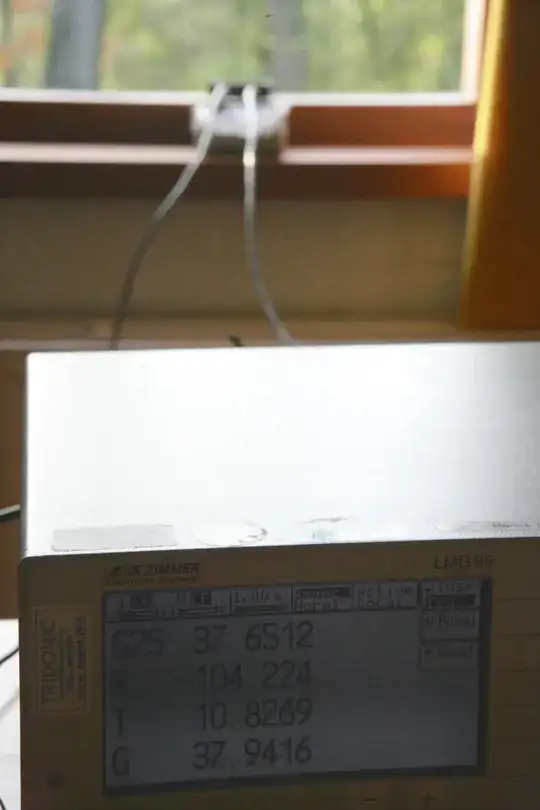

Photo of result
The irradiance is low in winter. To increase accuracy at low currents, an external shunt (LMG-SH020-P) has been used in the depicted setup. LMG95 + ISE WPVS RS-ID-5
