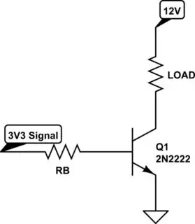

You could use your 2N2222 as a switch. This is a BJT transistor, so you need to add an appropriate base resistor. It is well documented how to use a BJT as a switch, but in general, it looks like this:
Now, you need to make sure your load current is within the specs of your 2N2222 (I think this is <700mA). See this question if you want to know how to determine the appropriate base resistor value.
