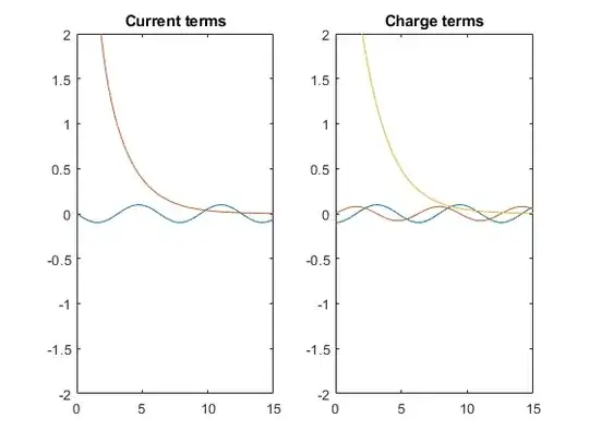

Less common are diagrams showing a Laplace transform decomposition, but I found this example analyzing an RLC circuit: Transient response of RLC circuit
On the top left plot you can see the inductor current over time, with a large decaying transient from 0 to 5 seconds. On the bottom left plot you can see the end of the initial transient and the final steady state behavior (note the large change in plot scale!).
And the corresponding Laplace decomposition: Laplace decomposition of RLC circuit
Here you can see that the total response in the first plot is the sum of the two terms plotted here, and that the impact of the initial transient decays to zero over time.
