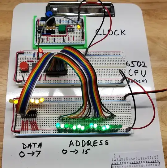

Back in the old days, we used actual breadboards for this. These were heavy wooden cutting boards, usually stolen from Mom. This is in fact, where the term "breadboard" comes from, as a place to put electronic projects.
https://en.wikipedia.org/wiki/Breadboard
Today, I use clipboards for this purpose, and this provides most of what you're looking for. It keeps the project together and gives it some weight. Clipboards are also great for storing projects out of the way when working on something else.
You can use many different methods to fix items to the clipboard. Sometimes I use the clip itself, sometimes I use packing tape, sometimes double-sided tape, etc. Dry-erase clipboards like in the photo are very handy for making notes, but they are a little more expensive.
https://youtu.be/grLyHi-wfoo - see this technique "in action"
