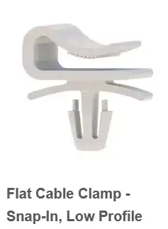

There are also a variety of flat tie holders that can also facilitate zip ties. These can be pushed in or fastened with fasteners.
Snap-in cable clamps (many different varieties) can be used in PCBs with one through hole.
Enter image description here
Source: Flat Cable Clamp - Snap-In, Low Profile (Essentra Components)

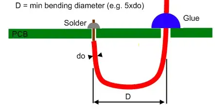

One very simple technique used on spaceflight PCBs (and thus good against vibration) for a small number of cables is to insert the wire through one hole, and solder the stripped end at a distance from that hole corresponding to the minimum bending diameter of the wire (which may be assumed 5 times the outer diameter if you do not know it). A spot of glue (epoxy or hot glue if not available) is then added to relief the solder from mechanical stress.
The minimum bending diameter is not only chosen to reduce the footprint on the PCB, but also to ensure the wire has some curvature inside the glue: if the wire is straight, since wires are often insulated with PTFE which has very low adhesion to most glues, the wires would have very low resistance to pulling.
Note that for larger number of wires, we also use T-wraps (at least the shape of it, most plastics release too much gas in vacuum) such as presented by Dave Tweed in addition to custom clamping parts: it yields very good resistance.
