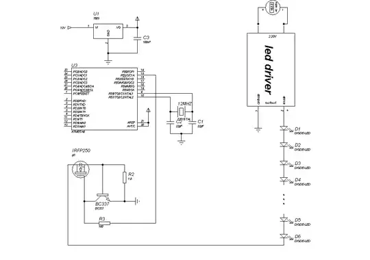

There's a lot of post on here about MOSFETs and ESD sensitivity. But whenever the general question is asked, people always go straight to the gate and how sensitive it is.
I've developed an LED driver board, with common-annode LEDs connected. Therefore, I have the drain of the low-side N-Channel MOSFETs exposed - and lots of them. The board has 52 of these exposed:
Since I have so many, I really don't want to have to place 30V+ TVS diodes on every single output. If I have no choice, I guess I will. But I was just wondering - since they do have a parasitic body diode, is there any chance the drain will be okay - at least for EMC testing - by itself?
