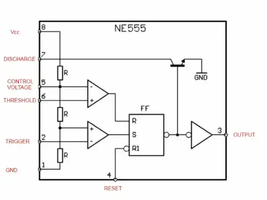

Check out pin 5 on the 555. It's the control pin, and it is not documented well. But if you look a the datasheet, you'll see that pin 5 sets the reference voltage for the comparator and by changing that you can change the PWM duty cycle.
wikipedia description of pin 5:
Control (or Control Voltage): this pin provides access to the internal voltage divider (​2⁄3 VCC by default). By applying a voltage to the CONT input one can alter the timing characteristics of the device. In most applications this pin is not used, thus a 10 nF decoupling capacitor (film or C0G) should be connected between this pin and GND to ensure electrical noise doesn't affect the internal voltage divider.2 This control pin input can be used to build an astable multivibrator with a frequency-modulated output.
Here is an image of the internals of the 555. You can see that pin 5 goes to an internal voltage divider \$\frac{2}{3}*Vcc\$. You can connect the pot there and cause the duty cycle to change.
Aaron
  • 7,274
  • 30
  • Just be aware that there is a nonlinear relationship between the voltage on the CV pin and the output duty cycle. – Caleb Reister Oct 16 '19 at 02:13
