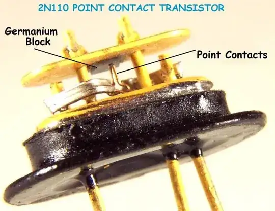

The first transistors used point-contact junctions, which themselves had small dimensions (which is why point-contact diodes work well at high frequencies). However carrier transit time between Collector and Emitter was proportional to the cube of their separation, so performance diminished rapidly as distance increased. To get a cutoff frequency of 20MHz required that the contact points be only 1 mil (0.025mm) apart, which was difficult to achieve and maintain.
Inside 2N110 Point Contact Transistor:-
