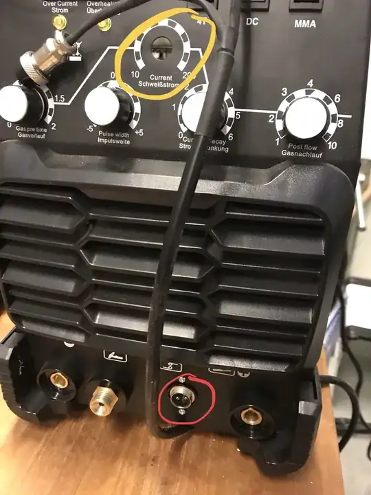

I've got a simple tig welder that uses a switch on the torch to start the welding current and a potentiometer on the front panel to set the amperage. Many welders make use of a foot pedal to start te welding current and also control the amperage level with your foot for a bit more control of the welding action. This welder doesn't officially have a way of connecting a foot pedal but I think it must be possible and tried adding one.
Tig welder
I bought a foot pedal that has a two pin connector and a three pin connector. The two pin connecter wil connect to my tig welder as is and it will trigger the welder to start just like the button from my torch would. I've now got foot control but can't manipulate the amperage.

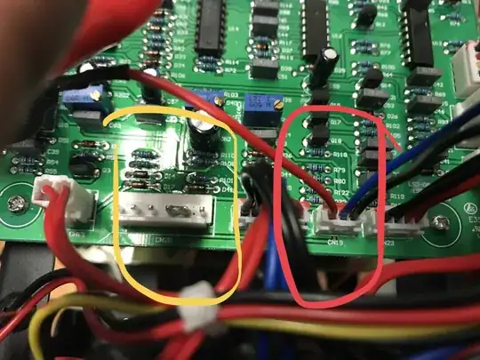

Inside the welder the pot meter is hooked up to the connecter circled red. The outer lobes trace to a bunch of resistors and the centre lobe traces to two pins soldered together on the unused connector circled yellow. Maybe that connecter is there for adding a foot pedal. I can't seem to find any info on this welder anywhere.

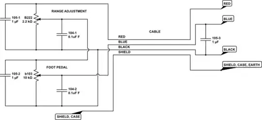

Assume that the "Firstly" and "Secondly" worked, then, this is what would make it work even better (may be?). The cable is 3 wire in shield.
