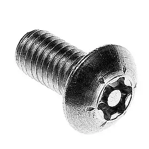

Instead of using cover safety switches, you can bolt the cover with special screws. If they are non-standard it means that you need a special tool and it is assumed that only trained personnel would open the cover, so he/she knows the risks. Further you apply a sticker: Do not open before disconnecting power wires.

  • These type of fasteners have never stopped me from getting in to anything – Voltage Spike Sep 26 '19 at 18:56
  • You do need a tool to remove this. _any screening within the protective housing so that tools are required for their removal;_ (tool denotes a screwdriver, a coin or other object which may be used to operate a screw or similar fixing means) – D Duck Sep 26 '19 at 19:50
    @VoltageSpike Me neither, but it can stop some bureaucracy. – Marko Buršič Sep 26 '19 at 20:08
