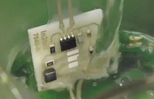

Researchers from the National Physical Laboratory (NPL), in London, in cooperation with partners In2Teck Ltd and Gwent Electronic Materials Ltd, have developed a 3D printable circuit board that separates into individual components when immersed in hot water. The goal of the ReUSE project was to increase the recyclability of electronic assemblies in order to reduce the ever-increasing amount of electronic waste.
Source: http://environmentaltestanddesign.com/dissolvable-printed-circuit-board-recycled-with-hot-water/
