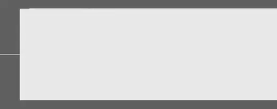

The “Electronic Devices and Circuit Theory” book (by Boylestad, Nashelsky) gives a brief description of a random noise generator circuit at the end of “BJT AC Analysis” chapter. (Btw, exactly the same circuit appeared in the IET magazine, April 1976).
schematic diagram
DC analysis is straightforward: Q3 stage represents a 'classical' collector feedback bias. At \$V_{cc} = 21 V, \beta=100\$ we get \$A_v = 280, Z_{in} = 1.28 k\Omega\$. No surprises there. However, their description of what happens at high frequencies (where the 3 db/octave filter’s capacitors kick-in) baffles me. The exact quote from the book:
At a sufficiently high frequency all the capacitors could be replaced by short circuits, and the total resistance combination between collector and base would be reduced to about \$14.5 k\Omega\$. which would result in a very high unloaded gain of about \$731\$, more than twice that just obtained with \$R_F = 1 M\Omega\$. Because the 1/f filter is supposed to reduce the gain at high frequencies, it initially appears as though there is an error in design. However, the input impedance has dropped to about \$19.33 \Omega\$, which is a 66-fold drop from the level obtained with \$R_F = 1 M\Omega\$.

  • the old Rin (1.28K ohm), scaled by (18K||100K||390K) / 1Mohm, is 19 ohms. – analogsystemsrf Sep 20 '19 at 16:14
