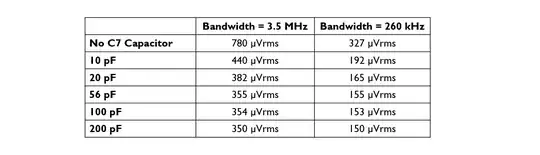

Following suggestions in the comments and answers, I have tried adding two additional capacitors, shown below:
C7 is to limit the bandwidth of the op amp feedback, and therefore hopefully some of the noise. C6 is is an attempt to low pass filter the noise coming from the LM4040 +10V reference, which has the following noise specs from the datasheet:
As pointed out by analogsystemsrf, the LM4040 has quite a lot of noise already. Using the tool https://apps.automeris.io/wpd/ I have extracted the noise spectral density from the picture in the datasheet, and then numerically integrated this spectrum over various bandwidths to get the expected rms noise cumulatively as a function of bandwidth. With a 10 kHz bandwidth, we can expect ~170 µVrms (as stated explicitly in the datasheet), and this increases to 350 µVrms for a 100 kHz bandwidth:
With the addition of the two capacitors, the noise at the output is measured for both a shorted input, and with 1 VDC being sent from the function generator: enter image description here
When trying different values of C6 (always with the 100 pF feedback cap), the noise changes as follows:
No capacitor:     217 µVrms
1 nF capacitor:   167 µVrms
10 nF capacitor:  123 µVrms
100 nF capacitor: 118 µVrms
1 µF capacitor:   117 µVrms
10 µF capacitor:  116 µVrms

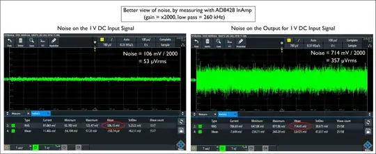

As suggested by VoltageSpike, I have also done some tests with R2 disconnected and V_IN grounded, in order to remove the extra complication of noise from the LM4040 reference. The effective schematic is then simply the following:
Then the output noise is measured using the AD8428 instrumentation amplifier, with two different bandwidths - the first is the standard bandwidth of the AD8428 amplifier of 3.5 MHz, and the second is with an additional 260 kHz low pass filter before the AD8428 amplifier. The following table shows the result of changing the value of C7:
Then, after selecting the 56 pF capacitor based on the above data, I have also measured the effect of adding additional filtering capacitors to the power rails of the op amp - specifically, an extra 10 µF and a 100 µF were added to each of the positive and negative rails, changing the noise as follows:
It seems now as if the output noise is coming down to the range of the power supply rails noise. Although, I don't understand why there is so much more noise on the output than the PSU rails when measuring over a 3.5 MHz bandwidth, given the fact that the op amp bandwidth should be limited to tens of kilohertz by the 56 pF capacitor C7.

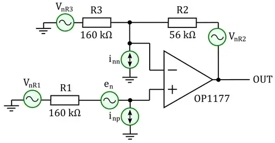

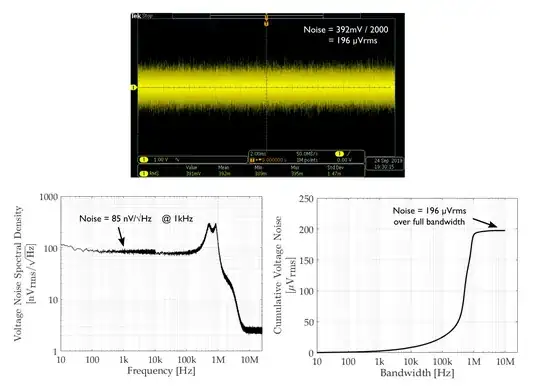

I have managed to get around to taking a noise spectrum of my simplified op amp circuit shown above. There is no C7 capacitor fitted, and the noise was again measured using the AD8428 amplifier (gain x2000, bandwidth 3.5 MHz). Also, to remove the possibility of my power supply rails dominating the op amp output noise, I have been powering the circuit using dual ±9V batteries.
Shown below is the oscilloscope trace, which indicates an RMS output noise of 196 µVrms. I have also then converted the time series data into a voltage spectral density, and the corresponding cumulative RMS noise curve (by integrating the spectral density over the relevant bandwith):
From the data, I am able to read off a voltage noise of ~85 nV/√Hz. Following this TI Application Report, and the book Noise Reduction Techniques in Electronic Systems (Ott, H.), I made an attempt to learn how to arrive at this number. First, I associate noise sources with the various elements - namely, thermal noises of each resistor, and the input voltage noise and input current noise of the OP1177 op amp:
After doing this, I calculate the following noise contributions:
RESISTOR THERMAL NOISE ( using \$\sqrt{4k_BTRB}\$ ):
For R1 - noise = 51 nV/√Hz * 1.35 = 68.9 nV/√Hz
For R2 - noise = 31 nV/√Hz * 1 = 31 nV/√Hz
For R3 - noise = 51 nV/√Hz * 0.35 = 17.9 nV/√Hz
The factors of 1.35 and 0.35 are the gains due to the op amp, depending on whether it is applied in inverting or non-inverting configuration for the various noise sources. So, total resistor thermal noise is found by adding the noise sources by the sum of the squares to be 77 nV/√Hz.
OP AMP INPUT VOLTAGE NOISE:
This is given in the OP1177 datasheet to be 7.9 nV/√Hz (at 1 kHz), and is subject to a gain of x1.35. Therefore its contribution is 10.7 nV/√Hz.
OP AMP INPUT CURRENT NOISE:
From the datasheet, the input current noise is 0.2 pA/√Hz (at 1 kHz). This will develop into a voltage noise across R1, and then due to the gain will contribute of 0.2 pA/√Hz * 160 kΩ * 1.35 = 43.2 nV/√Hz on the output. Similarly, it will also produce a voltage across R2 and contribute an additional 0.2 pA/√Hz * 56 kΩ = 11.2 nV/√Hz. Adding these in quadrature gives 44.6 nV/√Hz coming from the input current noise.
To get the total output voltage noise, we should simply have to add all three noise sources in quadrature, to arrive at:
\$\sqrt{(77\;\;\textrm{nV}/\sqrt{\textrm{Hz}})^2 + (10.7\;\;\textrm{nV}/\sqrt{\textrm{Hz}})^2 + (44.6\;\;\textrm{nV}/\sqrt{\textrm{Hz}})^2}\$ \$\approx 90 \;\;\textrm{nV}/\sqrt{\textrm{Hz}}\$
This seems to agree reasonably well with my measurement above of 85 nV/√Hz, and so these calculations seem to work okay.
However, I then obtained the SPICE model for the OP117 from the Analog Devices website here, and tried to reproduce this in LTSpice. The result is shown below:
It can be seen that LTSpice predicts something like 207 nV/√Hz, which is very different to both the measured value and the value obtained from the simple hand calculations. Can anyone help to shed any light on what might have gone wrong here? Am I misunderstanding how to do the noise calculations, or did I make a mistake in LTSpice?
Note that when configuring the OP1177 as a buffer without resistors, to measure its input voltage noise, LTSpice seems to give the correct value given in the datasheet of 7.9 nV/√Hz:

The righthand opamp U3 is an awkward circuit to convert to low-pass-filter. A capacitor across the Rfeedback merely ensures the high-frequency gain = 1.000, which lets all the opamp noise and the Vnoise of R3 160K to appear on the output.
Assuming no noise entering the Vin-, nor the VDD pins, the opamp Rnoise of 4 Kohm can be added to the 160Kohm, thus predicting 164K ohm. Given 13*13 = 169, we'll scale up 4nV by 13, to 52 nanoVoltrms/rtHz, over 1MHz bandwidth.
The total integrated noise should be 52 microVolts rms. [ error Initially said 52 milliVolts]

  • Above C6 = 100 nF, the noise doesn't reduce significantly - details of trying different cap values has been added to an edit in the original question. – teeeeee Sep 18 '19 at 18:03

Now lets compute the NOISE to expect from a simplified version of the U3 opamp circuit
I've included Four items in the figure:
1) the noise density and the total integrated noise voltage in 1MHz bandwidth, for 1Kohm, for 10Kohm and for 100Kohm resistors. These values are 4 microVolts RMS, 12 microVolts RMS, and 40 microVolts RMS. Notice the 40 microVolts is near the measured value of your output noise, using 160Kohm resistor.
2) simplified circuit, at Gain=1 (Rfeedback = zero ohms) with opamp noise modeled at 4Kohm resistor (to produce 8 nanoVolts/rootHz noise density), with computation for expected output noise voltage of 52 microVolts
3) the effect of the inherent 5picoFarad parasitic capacitance on pin Vin- of the opamp, which gives a free reduction in bandwidth
4) a modified circuit, using output R+C lowpass (560 ohm and 10,000 pF) to reduce noise bandwidth, and a specially-connected prevent-loop-oscillation capacitor from opamp output to the Vin-, which allows the output LowPass to be effective.
