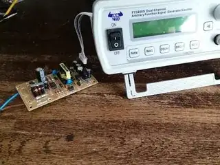

I actually own a FY3200S signal generator. When I bought it, I was already aware of the questionable quality of the switching power supply inside it, and the reported high earth leakage currents. For this reason, I replaced the built-in switch-mode power supply by a simple regulated linear power supply (a fairly common mod for these units). If you want to go this route, note that you'll need to provide +12V, -12V, and +5V.
I managed to find the original switch-mode PSU for the signal generator, so I hooked it back up, and took several measurements with both the original switcher and the new linear supply. I probably should have done that when I built the linear supply, but hey ¯\_(ツ)_/¯

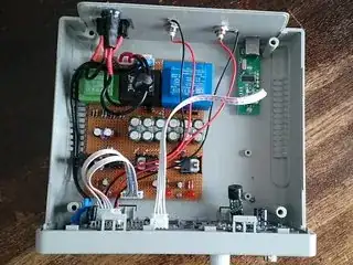

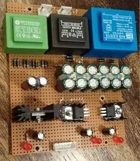

The implementation is messier than the schematic, because I had to make do with whatever parts I had laying around. In particular, the 5V rail is powered by two transformers that are paralleled after their bridges, and I had to use capacitors in series (with balancing resistors) on the ±12V rails to get the appropriate voltage rating (the rectified transformer output is like 24VDC to ground under no-load conditions).
Linear PSU top view Linear PSU bottom view

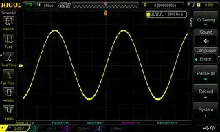

First a capture of the test waveform. Looks clean, no difference between PSUs.
Sine wave on switching PSU Sine wave on linear PSU

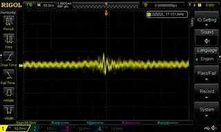

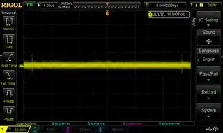

With the signal generator set to generate a 0V DC "signal", this is a capture of the signal (50mV/div, 5µs/div). The left image shows switching ripple at some 37kHz, which is absent on the right image:
Switching PSU noise 1 Linear PSU noise 1
A close-up of the switching ripple (50mV/div, 50ns/div). The left image shows the switching ripple. The right image just appeared to have random noise (which sometimes the scope would trigger on, sometimes not):

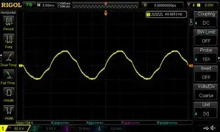

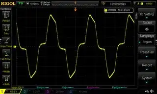

Earth leakage voltage
This is the heart of the question, and the most common reason to replace the PSU in these signal generators. It was measured by hooking up the oscilloscope or multimeter between my earth reference (central heating pipes) and the ground of the signal generator. The signal generator output signal itself (10Vpp 1kHz sine) was left unconnected.

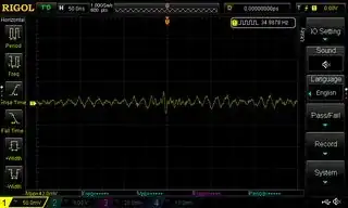

Clearly, the linear PSU still has earth leakage due to capacitive coupling in the transformers and perhaps wiring, but it looks better than the switching PSU (both image 50V/div, 5ms/div):
Switching PSU ground-to-earth wave Linear PSU ground-to-earth wave
Multimeter measurements confirm that the open-circuit ground-to-earth voltage is indeed lower for the linear PSU (39VAC RMS) than the switching PSU (92VAC RMS):
Switching PSU ground-to-earth voltage Linear PSU ground-to-earth voltage

But the real difference is in the earth leakage current; at 5.5µA, I'm slightly disappointed in the linear PSU performance here, but it's two orders of magnitude better than the switching PSU at 334µA!
Conclusion of sorts
So yeah. These things come with a crappy power supply. I have little faith in its safety, and ~0.3mA leakage current can ruin your day on sensitive circuits. And from what I've read online, some specimens exhibit >1mA leakage current.
However, replacing the PSU with a linear power supply can improve this a lot, and it can be a fun little project. I used linear power supplies for every rail (which also makes it easy to get rid of switching ripple), but I've heard of others using DC-DC converters to derive the necessary rails from a single external 12VDC or 5VDC power supply.
If you want to go this route, also consider what you'd like to do with the USB port, which is not isolated.
In the end, with my replacement linear PSU, the results look acceptable. No switching ripple, 5µA leakage current, 30VAC open-circuit earth-to-ground (which is still something to be careful with). It's not perfect, but for < $100 it's okay at the hobby level.
