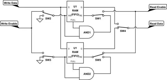

Double-buffering shouldn't require a parallel copy. The normal technique is to have two blocks of RAM, and when you get your "trigger" or whatever criteria you have to switch buffers, you simply switch which block you're writing to.
The switches represent multiplexers. In the current state, U1 is being written and U2 is being read. When your trigger occurs, flip all of the switches, and now you're writing to U2 and reading from U1.
If you're going to do this with FIFOs, the technique is similar, but there's a subtlety. Your problem description says that you essentially want to save the last 512 samples that were taken before the trigger, which implies that you will be throwing away data if the triggers are more than 512 samples apart. With FIFOs, you need to explicitly account for this, by removing data once they fill up. This is shown below with the addition of the AND gates.

  • Ok, this is similar to the plan I had in mind for now. But instead of RAMs, just two FIFO_DCs (I do have independent read and write clocks), and switch between them as you point out (the advantage with FIFOs is I don't need to handle myself the extra logic to generate addresses — since all of my accesses will be naturally sequential, FIFO structures should do) – Cal-linux Sep 13 '19 at 15:45
    Even the XO2-640 device should be big enough to do this -- it has two EBR SRAM blocks, each of which can be configured as a 512x18 FIFO. – Dave Tweed Sep 13 '19 at 15:48
  • Awesome, Dave Tweed, thanks! I was precisely unsure about this detail of having to extract when the FIFO buffer fills (I suspected that that was the case, but the documentation does not explicitly say that — I guess they assume it is part of the "standard definition" of a FIFO?) – Cal-linux Sep 14 '19 at 12:17
